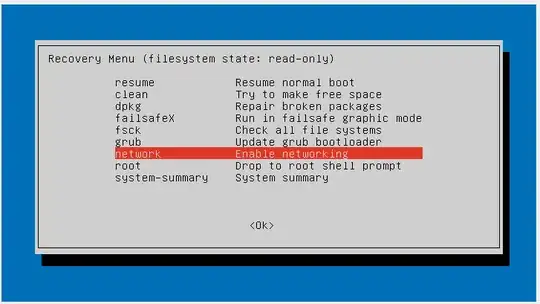

On the recovery mode menu, there should be an option to load network drivers:
Select that option, and confirm the request to remount the root filesystem in read-write mode. After some status text flashed by, you should arrive at the menu again, but with network drivers loaded. From there, select the option root to "drop to [a] root shell prompt."
You can then use sudo apt-get remove to remove the packages in question.
