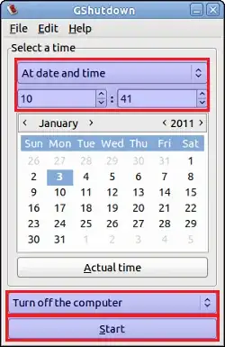

  • You can use gshutdown Install gshutdown
  • After installation it can be found under Applications → Accessories → GShutdown alt text
  • Also have a look at this method.
