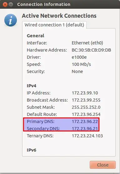

16
Go to the network connections next to the volume icon in the taskbar and click on Connection Information
Connection Information Screenshot
