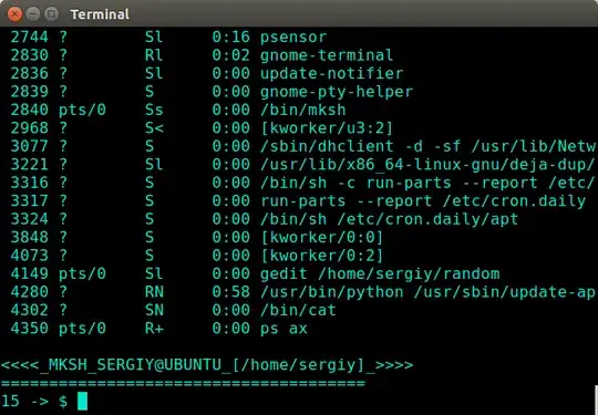

What if you wanted to find out which program opened that file ? Well you could go to about or help tab in drop down menu for that progra OR, you could run ps ax in terminal. For instance, I opened a random text file with gnome-open, and it brought up some text editor, but i wanna know which it is. So , I executed ps ax
Do you see line with process 4149 ? It says gedit /home/sergiy/random . So, my random text file was opened with gedit text editor.
