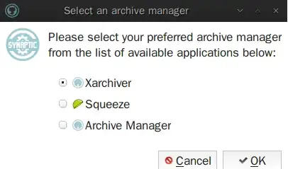

I have installed 7pzip and peazip to handle archives but after setting one of them as default and using Extract here or Compress/Create archive I am prompted as below
Selecting one in the list makes it the default archive manager, overwriting my previous setting.
This happens in PCManFM and Thunar, but not in Nautilus.
PCManFM is my default file manager as I am in Lubuntu 12.10 and have to keep using that.
