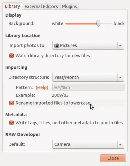

Shotwell can do this easily, it's in the preferences menu 'Rename imported files to lowercase':
Shotwell prefs
If Shotwell can't import directly from the iPhone, just copy the images to your Desktop and then import them into Shotwell from there.
