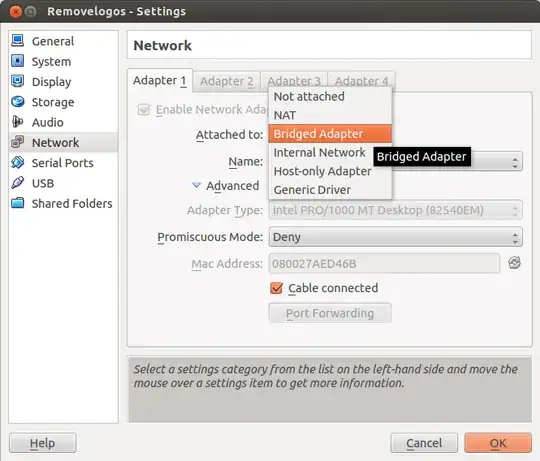

First you should change the Network adapater to Bridged (It seems you are choosing NAT)
Then you can give an ip to your guest machine other than 10.0.2.15 (or you can leave it if you want)
then open a browser from your host machine and type: ip-address-of-your-guest-machine/...
