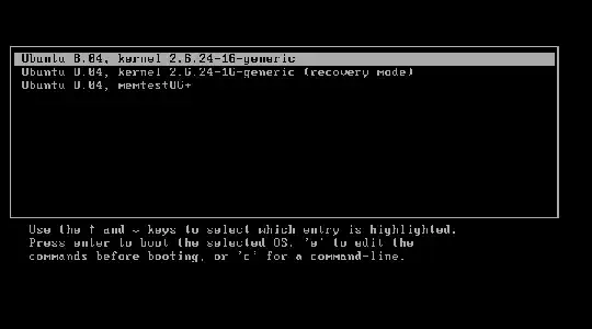

Tthe GRand Unified Bootloader is the software that is loaded by your computer after it turns on (after your computer's BIOS loading screens). GRUB then either automatically boots Ubuntu or gives you a list of installed Operating Systems and lets you choose one to boot (people not dual booting will probably not see the GRUB interface below).
GRUB Screenshot

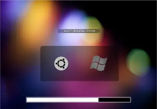

As for BURG - the capitalisation seems to depend who you ask - it is a fork of GRUB.The main reason most users consider BURG is for the theming possibilities, replacing the two colour boot screen above, with (for example) the interface below.
A BURG theme
