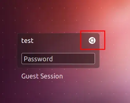

If you're wanting the "Application" menu, you would need to use GNOME2. You can use GNOME2 by selecting it on your login page. It should be listed as "GNOME (Classic)".
If it's not located in the above box, run sudo apt-get install gnome-panel, logout, and try again.
