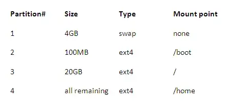

I would recommend the following configuration
A separate partition for home enables you to later install other os without destroying your data.
