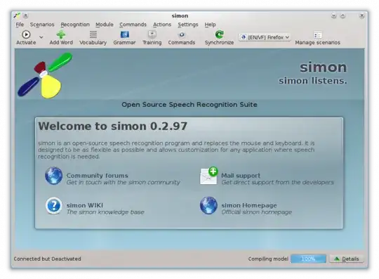

If you would like to make and use your own voice commands ("Update system now") try Simon listens.
Simon Listens
Installation:
sudo add-apt-repository ppa:grasch-simon-listens/simon
sudo apt-get update
sudo apt-get install simon
In Simon, for example, you can record a command and link it to a bash-script doing what you want or link it to DBUS-commands. In this way it is very easy to create any voice command! I tried it and it works fine. The more you train your Speech-commands, the better it understands your commands after that.
Screenshot
