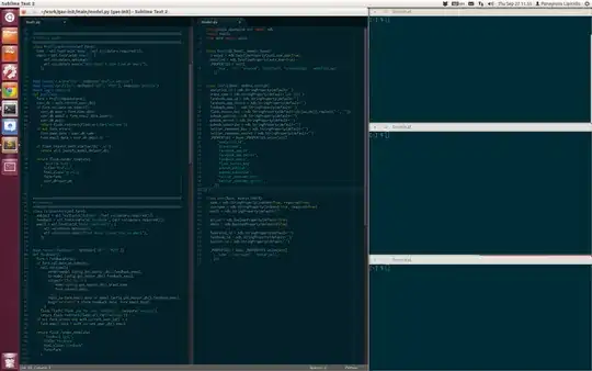

What I want to be able to save the current positions of my applications, so when I'm going to open the same ones and run something they will rearrange as they were.
For example if I'm going to open a sublime and three terminal windows I would like to be able to save that somehow.
I don't care if it's an app or a command line tool, as long as I can easily save the positions of my apps.

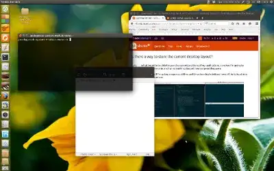

The script below can be run with two options. Let's say you have the window arrangement as below:
To read (remember) the current window arrangement and their applications, run the script with the option:
<script> -read

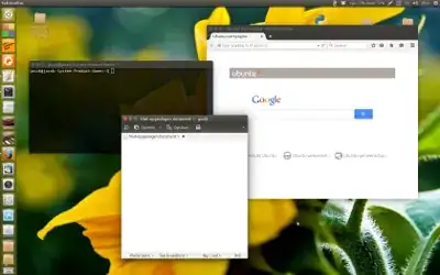

Then to set up the last remembered window arrangement, run it with the option:
<script> -run
and the last remembered window arrangement will be restored:
This will also work after a restart.
Putting the two commands under two different shortcut keys, you can "record" your window arrangement, shutdown your computer and recall the same window arrangement after (e.g.) a restart.
