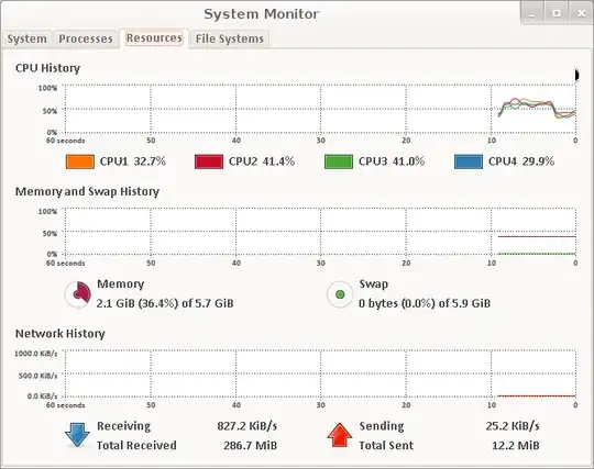

Acording to my laptop website and intel website, my CPU is Intel i5-2410M
Processor Number i5-2410M Cores 2 Threads 4 Clock Speed 2.3 GHz Max Turbo Frequency 2.9 GHz
so I have two cores, but why does ubuntu 12.04 show 4 cpus for my cpu ?
It is because of hyper-threading, where each core can (put simply) execute two threads simultaneously Which is why you see 4 threads, 4 threads == 4 'cpus'.
Quoted from wikipedia:
Hyper-threading works by duplicating certain sections of the processor—those that store the architectural state—but not duplicating the main execution resources. This allows a hyper-threading processor to appear as two "logical" processors to the host operating system, allowing the operating system to schedule two threads or processes simultaneously.
As l300lbl stated it must be because of hyper-threading. More information can be found on wiki.
What it basically do is to let you use one physical core as two logical ones. For example if you have a quad-core processor with hyper-threading technology it will let you to have 8 logical cores from 4 physical cores.
Intel did a nice job using this technology by allowing you to have double the threads that you would have without hyper-threading.
Also, seems that only Intel chips seems to use such technology, other chip manufactures focus on creating more physical cores instead of hyper-threading. My guess is that physical cores > logical cores :)
