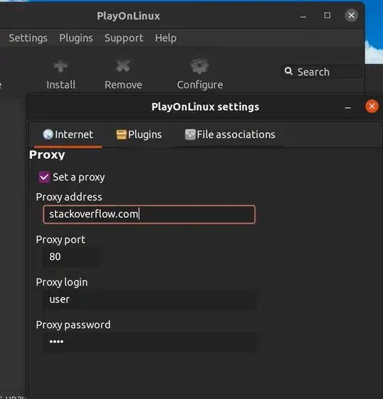

It is not the cleanest solution, but as a temporary solution for PlayOnLinux users, it is easy and fast to setup.
Go to Settings > Internet
Enable Set a proxy and enter a website without a proxy e.g. stackoverflow.com and random user name and password. The programs won't reach the proxy server or the internet.
Warning: Be aware, that this will also prevent the install dialog from searching and installing new software!
