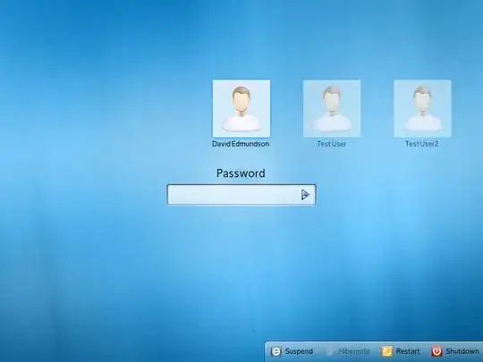

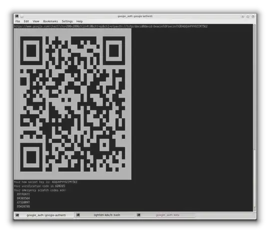

Take a look at this blog post titled: Google Two-Step Authentication On Your Desktop What is it?
Installation
sudo apt-get install libpam-google-authenticator
Usage
   ss #1                                                 ss #2

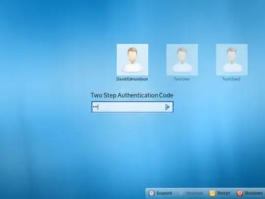

According to the blog post there's a version of lightdm-kde that has the 2 factor authentication included which can take advantage of Google Authenticator when you add the included PAM module into your environment.
auth required pam_google_authenticator.so
Resulting in your GUI logins looking like this:
ss #3 ss #4
source here
