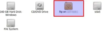

  • You can use nautilus to connect to the server.
  • Goto Places → Connect to server → ftp
    alt text
  • After connecting to it,you can see it in your nautilus.
  • You can search it like any other filesystem you can access. alt text
