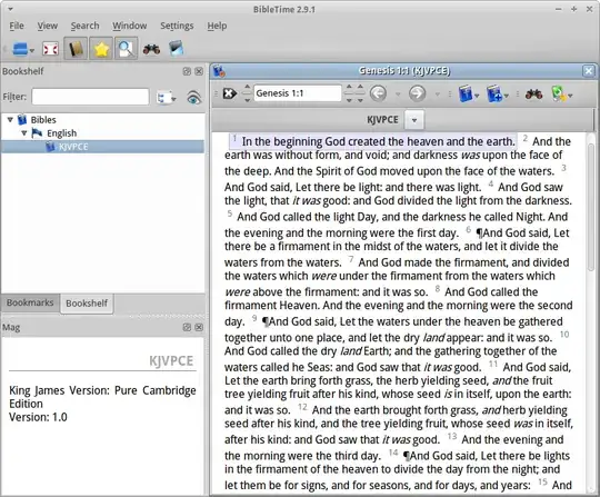

I managed to install Bibletime 2.9.1 on Ubuntu 12.04.1 64 bit. This is how:
  1. Added the following repository deb http://ftp.de.debian.org/debian sid main 2. In a terminal I typed sudo apt-get update
  2. Followed by sudo apt-get install bibletime ignoring the warning messages
  3. I removed the two software sources not to contaminate my system with other 'updates'
  4. sudo apt-get update for the second time to clean the package cache.
