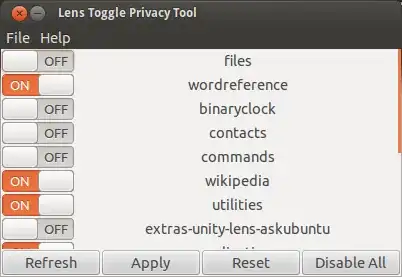

Lens Toggler has appeared, it can be installed using
sudo add-apt-repository ppa:aking1012-com/lenstoggle
sudo apt-get update
sudo apt-get install python-lenstoggler`
This is the thing I was asking for:
Lens Toggle Interface
