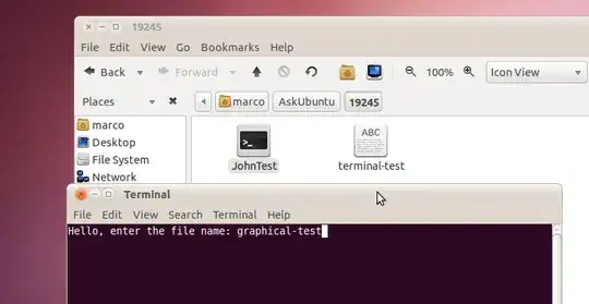

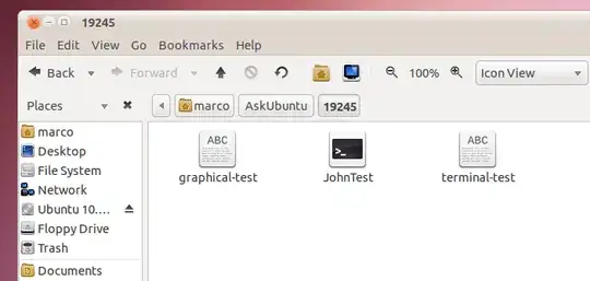

What happens when you run the script directly from the terminal? Typically if the sudo password has been typed once it's remembered for 15 minutes. If you run it graphically the terminal prompt will close after a complete execution. I don't have an SVN repo to play with - however, I did a similar test which will gather input from a user and touch a file by that name.
#!/usr/bin/env bash
echo -n "Hello, enter the file name: "
read NAME
touch $NAME
echo "All done"
When executed from the terminal:
alt text
Then double clicked:
alt text
alt text
The prompt closes when complete but does what is requested.
