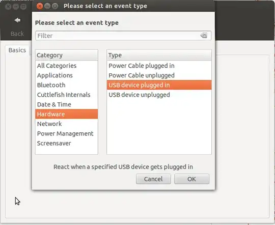

Cuttlefish is a program that can perform actions when events occur. For example, you can run a command when a USB is plugged in: enter image description here

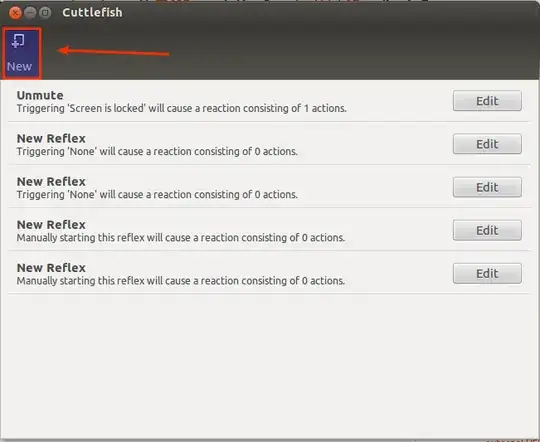

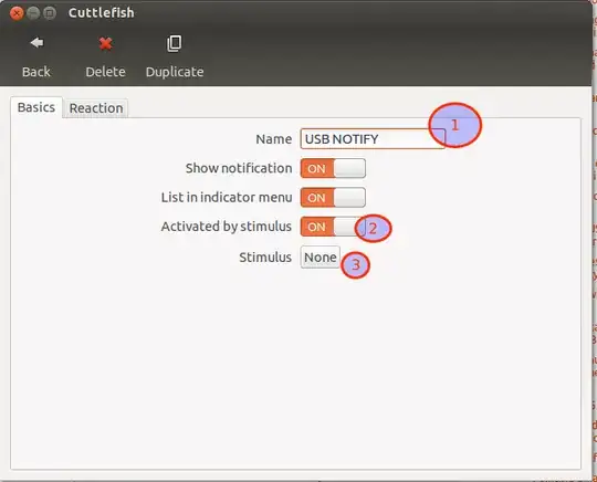

  1. Make a new Reflex from the upper left corner: enter image description here
  2. Give it the name of your preference, enable Activated by stimulus, and click on None so as to select a stimulus: enter image description here

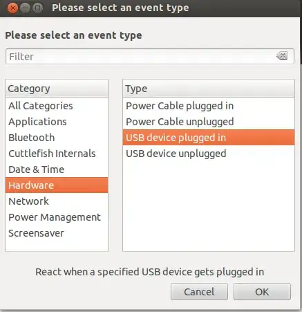

  3. Click on the left Hardware and on the right USB device plugged in. Then click OK. enter image description here

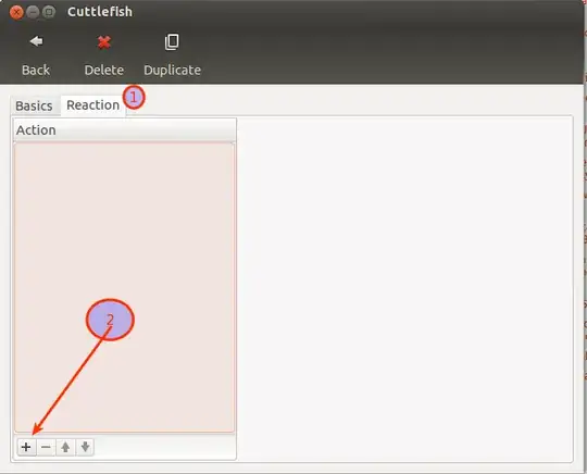

  4. Click on the reaction tab and click on the plus sign on the bottom left: enter image description here

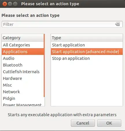

  5. Head to Applications->Start Application (advanced mode). Then click OK. enter image description here

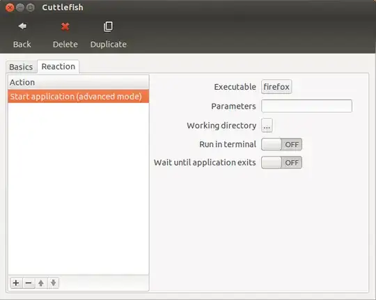

  6. Now, on the right, you can see that you can select an executable to run with any parameters you wish, so, you have to let Cuttlefish run on the system tray and it will run your command each time a USB device is plugged in: enter image description here
