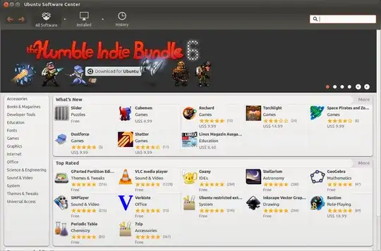

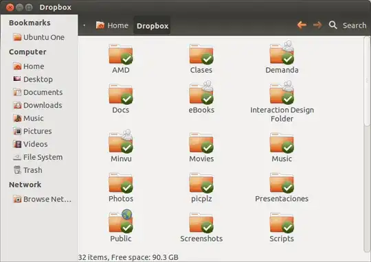

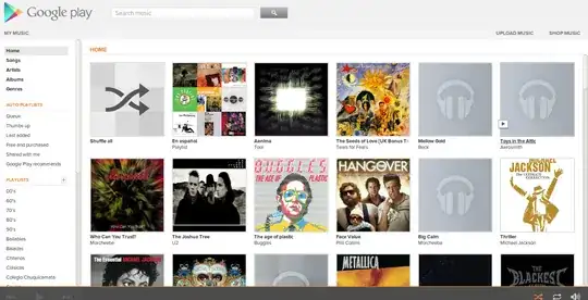

I know many people have complained about the almost invisible and not usable scrollbars in recent versions of Ubuntu, even after removing or disabling the default overlay scrollbars. I wonder how can I easily change their color AND width.
I have a 13.3 inches monitor with a 1600*900 resolution and I can barely see them, as you can see in these images:
http://placerdigital.net/up/Dropbox_003.png
http://placerdigital.net/up/Nuvola.png
http://placerdigital.net/up/Ubuntu%20Software%20Center_004.png
I already changed Firefox, LibreOffice and some other software's scrollbars using GNOME Color Chooser:
By the way, I'm using Unity. Thanks!
