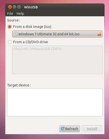

WinUSB worked fine for me last time I set up a dual-boot. You can install it either from the .deb package provided on the homepage or through a PPA:
sudo add-apt-repository ppa:colingille/freshlight
sudo apt-get update
sudo apt-get install winusb
The GUI should be straightforward and easy to use:
