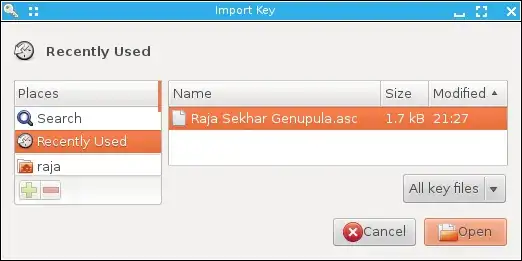

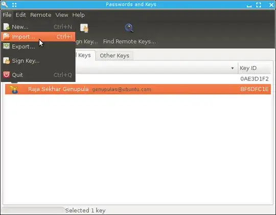

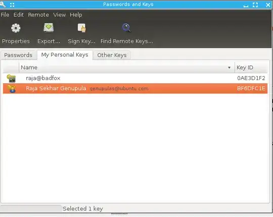

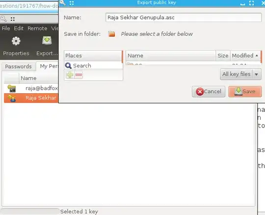

Open your unity dash and type as seahorse it will list you passwords and applications. click it to open . there your created keys will exist at My personal keys Tab. select that.There you can see your created key . select that key , then automatically in the menu export option will active and select that export button . then save it your desired location .
Now open your destination system where you would like to import this . There also as mentioned above same process upto opening passwords and application . In that application from main menu choose file and select Import . through you can choose the key which you have saved from your 1st PC .
Look at the images if you want more clarity . enter image description here enter image description here enter image description here enter image description here
