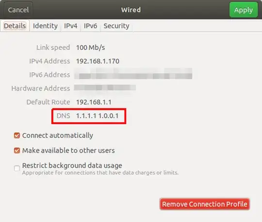

As a GUI alternative to @MartyFried's answer, try this.
  1. Click on the Network connectivity icon on the top panel.
  2. Select Wi-Fi Settings
  3. It should show you the DNS server address
    screenshot
