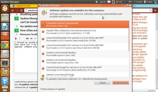

I noticed my system acting weird today. While the update manager (gui application) states that there are 14 updates selected, and 52 Mb will be downloaded, the apt-get upgrade command only informs me of 1 update to be downloaded and installed.
The Update Manager Gui (output) can be found here: enter image description here

From the CLI output you can see that some packages have been kept back, such as new kernel versions/headers. While update-manager installs them by default, apt-get requires the dist-upgrade parameter to include such packages in its upgrades.
Technically, apt-get upgrade will not install any new packages, e.g. linux-image-..., while dist-upgrade will. For more information on the differences between upgrade and dist-upgrade see here.
