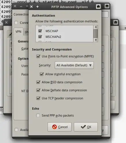

Whereas Windows appears to try different options automatically, you must configure Network Manager more manually.
Advanced Options screenshot
In Advanced Options there are a number of options; you need to find a combination that works.
