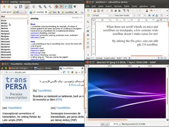

Here is the result (it will be a bit better now, because I’ve edited gtkrc after making these screenshots):
Change gtk-2 scrollbar to something like overlay
