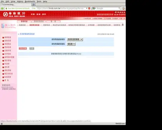

But in my Firefox in Xvfb on Ubuntu Server, the Chinese characters look like:
screenshot
How to install proper fonts for my Xvfb?

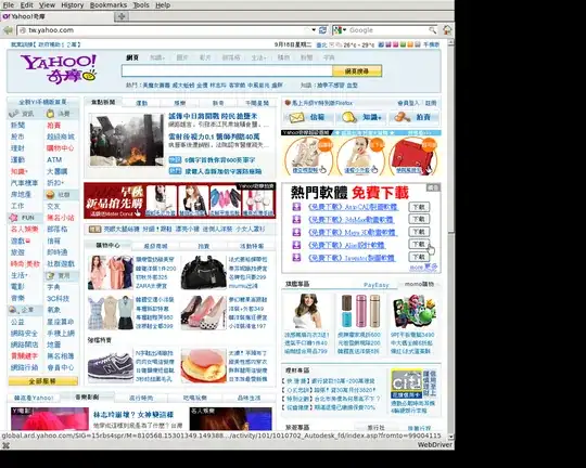

Solved!
You need xfonts-wqy as well. (it's a open-source Chinese font)
sudo apt-get install xfonts-wqy
