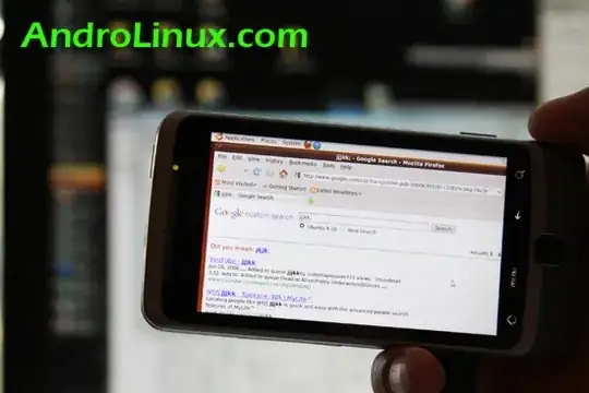

Actually, it's pretty easy if you are already rooted. You can find instructions on LinuxOnAndroid's website.
Once you've got your Nexus rooted download the Complete Linux Installer application.
I installed Lubuntu on my aging Samsung Captivate (AT&T's version of the first-generation Galaxy S), and it does work. I installed TeXlive on it and was able to edit and compile a couple of tex files, and preview them using evince or epdfview. It's pretty amazing actually.
Of course, for me it was just a fun project to try out, but I guess that, with a keyboard, a Nexus 7 could actually be useful as a Linux tablet. You do need enough storage capacity of course, because you are installing a desktop Linux distro after all.
