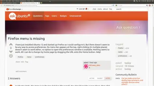

I have just installed Ubuntu 12 and started up Firefox so I could configure it. But there doesn't seem to be any way to access preferences. No menu bar appears at the top. right-clicking (in multiple places) doesn't seem to work either, no option to open the preferences window is available. Nothing seems to work. All I can do is change my home page by dragging the URL onto the Home button. Help!
