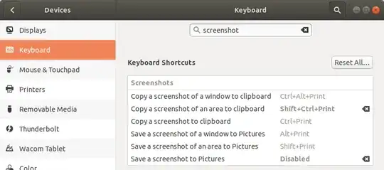

On Gnome Shell (17.10+)
To use the built-in gnome-screenshot capability (by default):
  • Ctrl+PrintScreen to copy a screenshot of the whole desktop.
  • Ctrl+Alt+PrintScreen to copy a screenshot of the current active window.
  • Ctrl+Shift+PrintScreen to copy a screenshot of an area you select with your mouse.
  • PrintScreen to save a screenshot of the whole desktop at /home/user/Pictures.
  • Alt+PrintScreen to save a screenshot of the current active window at /home/user/Pictures.
  • Shift+PrintScreen to save a screenshot of an area you select with your mouse at /home/user/Pictures.

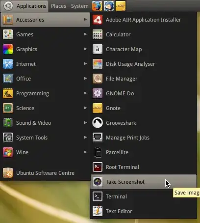

Applications > Accessories > Take Screenshot... Select area to grab.
Take Screenshot option in Accessories in Applications menu

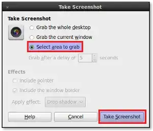

Method 1:
  • Go to Applications > Accessories > Take Screenshot
    Take Screenshot dialog
  • Now you can select the portion of a screen.

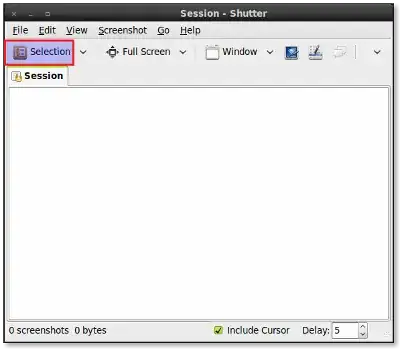

  • If you use shutter, Applications > Accessories > Shutter
  • Open it and click selection in the top of the screen.
    Selection option in top left of window
  • Now you can select the portion of the screen.

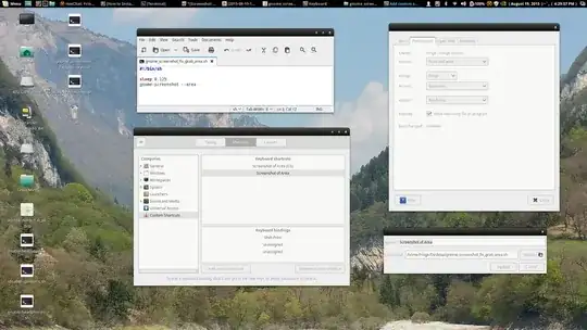

None of the answers worked for me in Linux mint 18 Cinnamon 64-bit,
The following thing in the screenshot worked for me,
Adding steps that I followed as suggested by Tshilidzi Mudau,
  1. Created a script gnome_area_screenshot.sh, contents of which are as follows,
#! /bin/sh
sleep 0.125 gnome-screenshot --area
  1. Opened Keyboard settings from settings menu.
  2. Click on Shortcuts tab.
  3. Click on Add Custom Shortcuts present at the bottom panel.
  4. Give name as 'Area Screenshot' (or anything you wish to).
  5. And Command as /gnome_area_screenshot.sh.
  6. In the Keyboard Shortcuts select 'Area Screenshot' and in the Keyboard bindings Double click and give any key combination which you wish to give as keyboard shortcut.

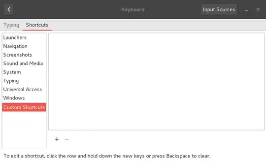

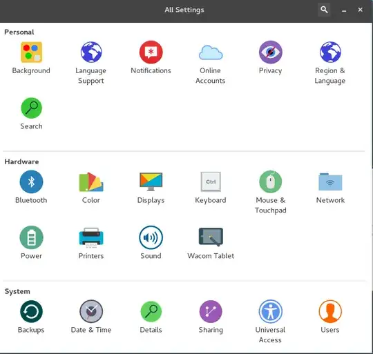

  1. Open system-keyboard-Shortcuts
    in Settings
  2. Click Custom Shortcuts

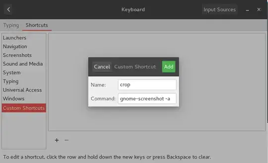

  3. Click the button + on the right
    adding custom shortcut option
  4. Add a name such as "crop", and add the following line (assuming you are using gnome)
     gnome-screenshot -a
    adding shortcut popup dialog
  5. Click add

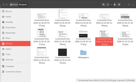

  6. Click "Disable" && set a shortcut as you wish
  7. Pictures would automatically saved in the folder Pictures
    Sample contents of Pictures
