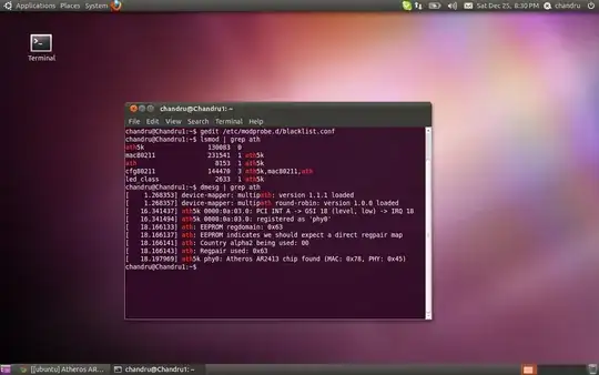

Some more information and output as to what i have done.
lsmod | grep ath
ath5k                 130083  0
mac80211              231541  1 ath5k
ath                     8153  1 ath5k
cfg80211              144470  3 ath5k,mac80211,ath
led_class               2633  1 ath5k
alt text
