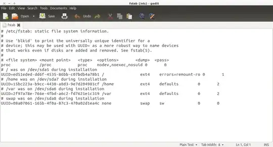

EDIT2: /etc/fstab

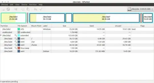

EDIT3: Screenshot of my hard disk.

I assume you have installed Debian in a way that it uses it's own separate swap partition. If you have not, I would suggest doing so (create another swap partition and change the /etc/fstab files accordingly), because too different operating systems writing to the same swap partition may discard hibernation data stored on the partition by the other OS.
Then you have to ensure that the OS you want to use hibernation on (usually both), writes to the correct partition. This is configured in the /etc/initramfs-tools/conf.d/resume file. You have to put the UUID of the correct swap partition in there (use sudo blkid /dev/$device_name to get the UUID). Finally you need to update the initial ramdisk:
sudo update-initramfs -u -k all
That should fix it.

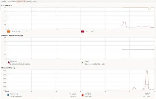

Some how my custom build computer configuration is not able to use hibernate tho I have more then enough swap space. image
