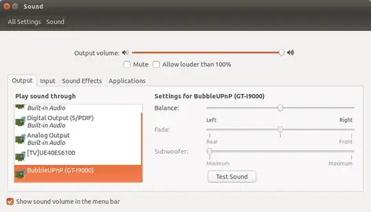

I created a little server which discovers all upnp renderers in your network and adds them as sinks to pulseaudio. So you can control every application via pavucontrol to play on your upnp devices.
That's the kind of comfort I always wanted when dealing with upnp devices under linux.
The application can be installed from source or DEB package downloadable from git, or after we had added the project's official ppa:qos/pulseaudio-dlna to our sources with:
sudo apt-get update && sudo apt-get install pulseaudio-dlna
We then run pulseaudio-dlna from the command line with following options:
pulseaudio-dlna [--host <host>] [--port <port>] [--encoder <encoder>] [--renderer-urls <urls>] [--debug]
pulseaudio-dlna [-h | --help | --version]
See also the pulseaudio-dlna "About" for more.
When there was a DLNA renderer present we can then select it from the sound menu as an output sink:

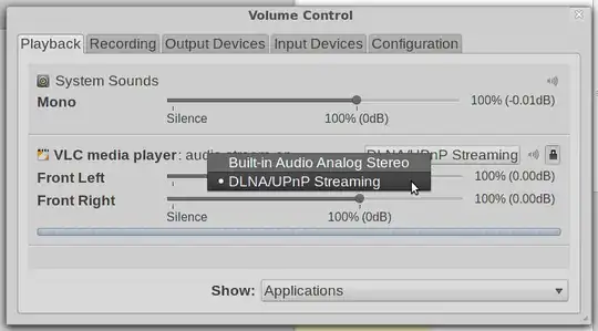

Pavucontrol is the missing item in this jigsaw puzzle! I had also set up everything correctly and the external device(LG TV) was showing that the sound was being played but I did not hear any sound. Today I installed pavucontrol and when I opened it I found the option to channel sound through the DLNA server. The DLNA option is only shown when there is sound output from a player to pulseaudio. enter image description here
