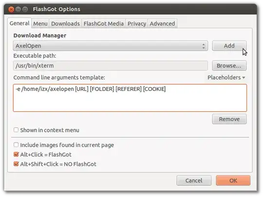

  2. Add the custom DL manager to FlashGot:
    • Open Flashgot options, and Add the custom manager, setting the executable to /usr/bin/xterm and the arguments as shown below:
    • xterm is only used because it is universal. You can also use, for example, gnome-terminal and change the -e to -x; this "run a command" option should be available for your other favorite terminal too, look at its man page.
