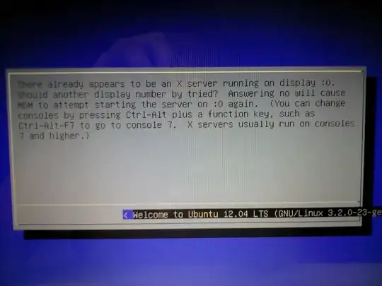

I installed MDM, and found it's incompatible with my VGA hardware. After rebooting I see:
This screen repeats, even if I choose Yes or No

What the message is telling you is that lightdm is already running in the background. So, login to the console-session/terminal by pressing Alt+F2, or choose Exit to console login from the window below.
