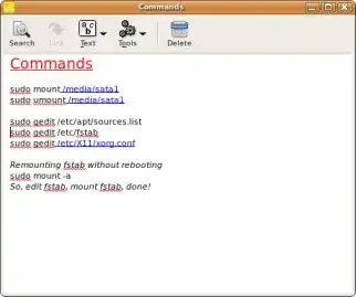

There are quite a few programs that can do that. One of the most well-known is Tomboy, and Screenlets is another option.
https://help.ubuntu.com/community/Tomboy
Installation
Part of the default Ubuntu installation
Tomboy works great with Dropbox!
