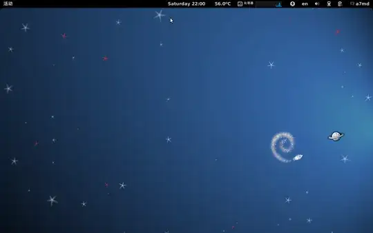

I logged in gnome-shell, and found that the display language is set to some strange Asian language (I think) without my prompt.
I tried to change the locale settings but found that the default language is English (how?) despite of that strange language.
Here's a snapshot, See the strange word instead of "Activity":
http://www.freeimagehosting.net/61gqp
I'm on Ubuntu 12.04 LTS.
