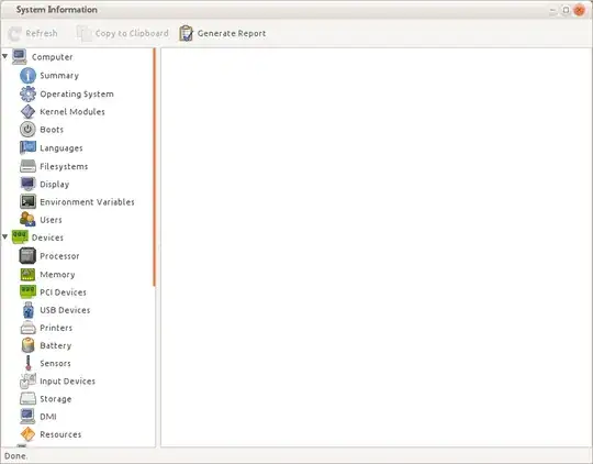

Install the hardinfo application:
This gives you a detailed readout of everything on your system, including driver information for your devices.
It won't tell you if there are newer drivers available, but that's not really a problem because on Linux the drivers usually come with the Kernel, so you don't really need to "upgrade" your drivers (except for certain drivers that are not included because they are proprietary).

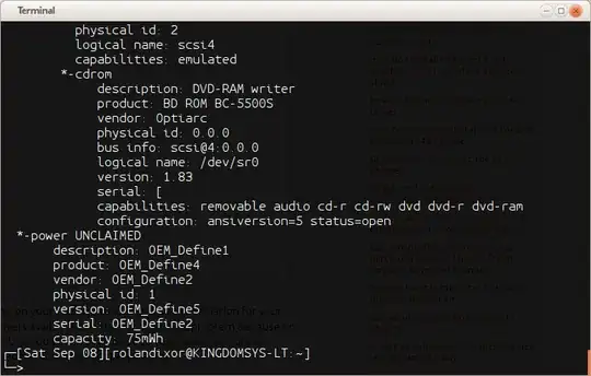

You can run sudo lshw to get a detailed readout of your system on the commandline:
Lshw
My recommendation is that you pipe the output to a file though as it can be rather hefty. So, run:
touch sysinfo.txt
sudo lshw > sysinfo.txt
You can then view this file at your leisure:
gedit sysinfo.txt
or
nano sysinfo.txt
As izx mentioned in the comments, any device marked as UNCLAIMED has no driver.

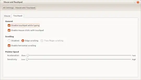

For your touchpad, you just need to change the settings. Open System Settings>Mouse & Touchpad, and under the "Touchpad" tab, you can set up two-finger scrolling.
