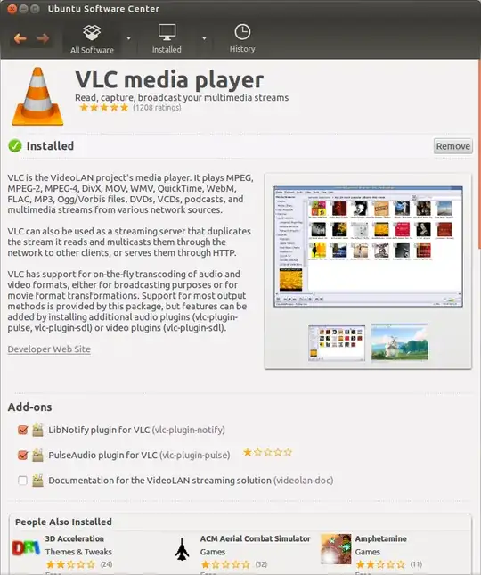

VLC can be installed from the Ubuntu Software Center : VLC Install VLC
