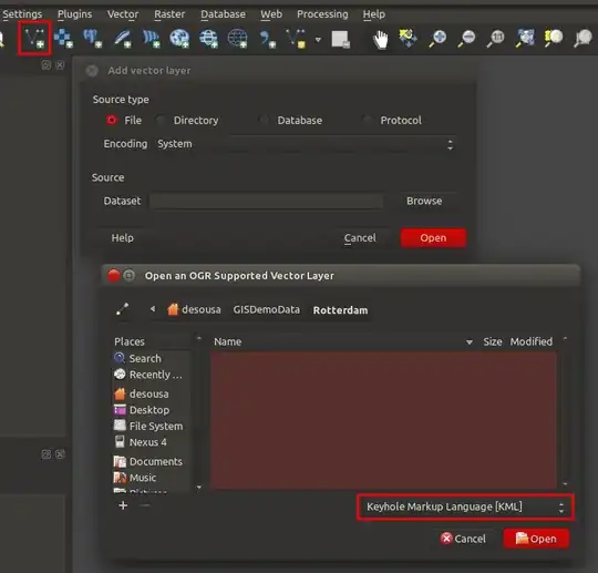

Any software reliant on GDAL for data input should be able to import KML files. On Ubuntu the most recommendable option is QGIS, that supports KML seamlessly. Using the Add Vector Layer dialogue you can import directly a KML file for visualisation and analysis.
