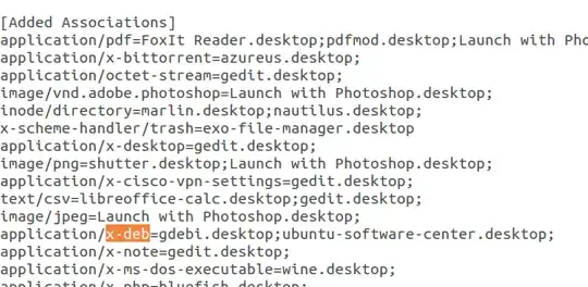

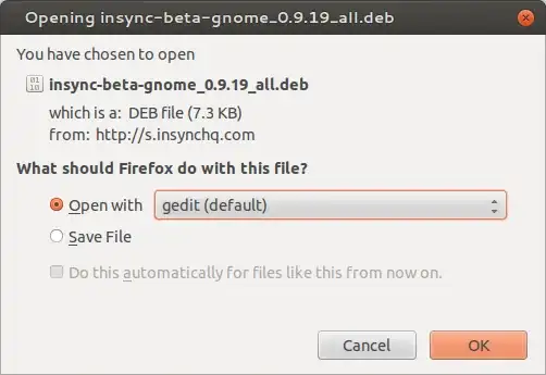

If I go to a website with a .deb link, Firefox downloads the file, then tries to open it with gedit. If I use Nautilus to open the .deb file, it runs it in either gdebi or Ubuntu Software Center (I've experimented with both).

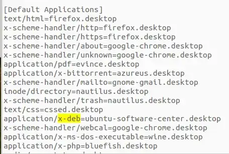

Oddly, no matter what I've done I can't seem to get Firefox to believe that debs should not be opened by gedit. See below from my mimeapps.list. Also, there are no references to my .deb files in /usr/share/applications/defaults.list
FF Opening In Dialog
~/.local/share/applications/mimeapps.list

To fix this, I opened .local/share/applications/mimeapps.list and removed the association of application/octet-stream with gedit.desktop. Doing that restored the normal/expected behaviour.

Firefox also has its own application list. Check Preferences->Applications, then find the Debian files. It probably says "Always ask" next to it if you haven't changed anything. If you click on "Always ask" you can select "Use other" and pick the Ubuntu software center or Synaptic or whatever you'd like it to be (though unfortunately you will have to use the file finder to actually get to the application file, which can be a slight annoyance). The Ubuntu Software Center is in /usr/bin/software-center and gdebi can be found in /usr/bin/gdebi-gtk.

There are default programs xdg-open and gnome-open which automatically select appropriate tool for a file.
I managed to find out that its enough to change association for unknown type and everything works fine.
Solution
This is everything you need BEGIN
sed 's#.*octet-stream.*#application/octet-stream=gnome-open.desktop#' ~/.local/share/applications/mimeapps.list -i

To fix the issue, you need to set the apps for the mime-type accordingly. The settings in /usr/share/applications/defaults.list should be correct.
You will notice that these ".desktop" files are located in /usr/share/applications/; you can use any in there and even create your own, with root privileges.
