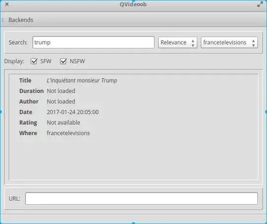

To just search and watch the video (in a rather limited integrated video player), you can use Qvideoob, the qt frontend of videoob.

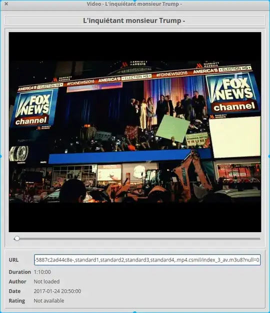

(The player window shows the url of the video, which can be copied and used in an external player - see below.)

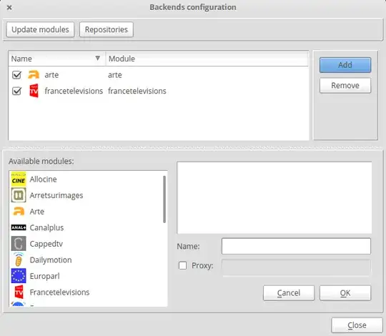

From there you can update and add new 'backends' (tv stations and such). Backends > Add. (The Weboob backends configuration tool can also be launched separately from a launcher like Dash.)

Also, the url of the video is displayed in the window of the Qvideoob integrated player as seen above.

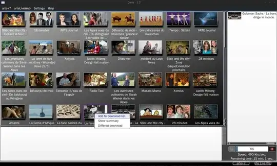

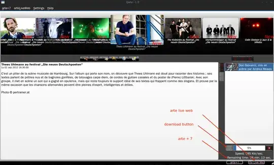

Qarte
(Source) - Also, thanks to Carl for posting an answer on Qarte in September 2015 on the new Qarte versions that work.
sudo add-apt-repository ppa:vincent-vandevyvre/vvv
sudo apt-get update
sudo apt-get install qarte
To download the deb, here.
Qarte has a second part dedicated to arte live web

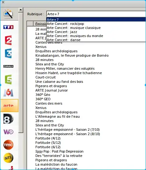

A very good tool is Captvty from Windows: to install that under Wine, see this separate post; installing it may take some time, but it may be very useful in that it displays all available titles for many stations without the need (and the possibility) to search.
