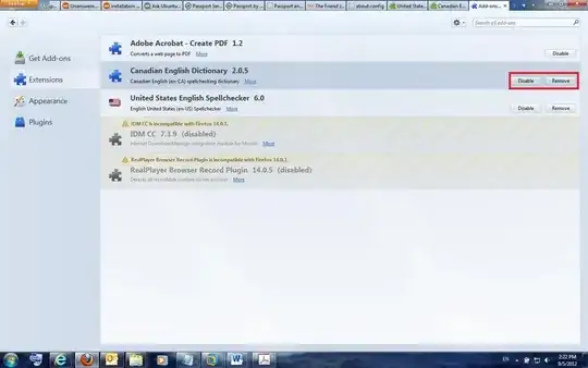

A simple answer is saying that a language pack is an Add-on.
  • Go to Tools -> Add-ons.
    If you are using Ubuntu 12.04 or newer, you can use Dash to search in your menu; Tap Alt, and start typing Add-ons.
  • After you open the Add-ons manager, click on the Languages tab in left menu. There, you can disable any language.

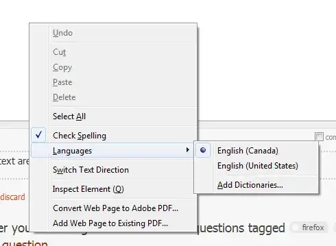

  • After adding a language, just right click on any text area, or input field (By default input fields have spell checking disabled, so you will need to enable it before proceeding to the next step.).
  • Choose Language from the context menu, and select the language you want, and this will become your default language until you change it again.
P.S. Clicking on "Add language" in the context menu, will take you to a page which contains a listing of language dictionary packs that links to their corresponding add-ons.

Right click on a text area, make sure that Check Spelling in checked, and choose the right dictionary.
Then go to the add-on page click on extensions, and either disable or remove the one that you don't want.
