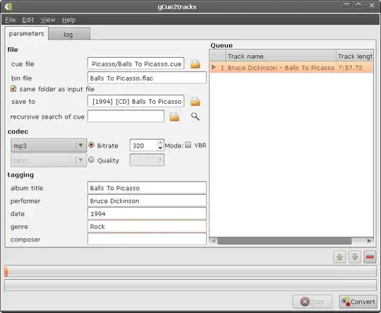

gCue2Tracks saved my life! Simple GUI, easy to use, efficient.
To install, add to your /etc/apt/sources.list file:
deb http://dicson.no-ip.info/repository/debian unstable main
And then:
sudo apt-get update && sudo apt-get install gcue2tracks
source: http://www.webupd8.org/2009/12/gcue2tracks-splits-compressed-audio-cd.html
