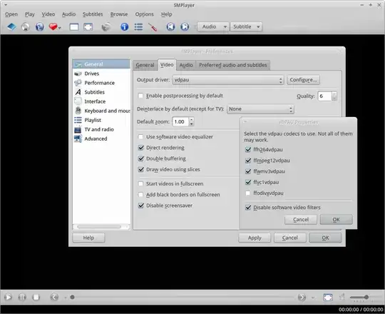

Using vdpau with Nvidia cards should get you great performance with smplayer, and will ensure that you use very little cpu when playing dvds and x264 encoded video. As has been discussed in detail on the Ubuntu forums, it is very important to note that
Vdpau is two things. One, a display device, like xv. The other, a codec that can use the PureVideo chip to decode certain files
such as mpeg1/2 and x264. If your card supports it (see here for a list of supported gpus) it is a better option than the old xv, and particularly xll, which will use considerably more cpu.
In smplayer there are some options that can be accessed via the configure button next to the vdpau option (see screenshot), but you usually don't have to fiddle with these unless you have any problems with the video performance.
NOTE: It is particularly important to note that when vdpau codecs such as ffh264vdpau are being utilised, none of the following smplayer gui options such as post-processing, deinterlace, etc, will have any effect. In the screenshot you can also see that 'disable software video filters' is checked when you click the vdpau properties.
However, as noted in the Mplayer manual special options such as deint can be passed on the command-line when using vdpau, although these are not usually needed; these special options are not supported in the smplayer gui.

So, when using vdpau you don't really need to worry about these special options or any other settings in the smplayer gui such as post-processing or direct rendering that you can't normally apply anyway when using vdpau.
Just to contribute to Mik's answer, you can use vdpau in smplayer and turn on deinterlacing by adding the command line arguments in the SMPlayer preferences menu.
Preferences > Advanced > Options for MPlayer
In the Options box, add the command line arguments you want. e.g.
-vo vdpau:deint=1
