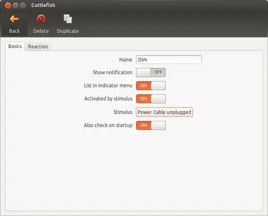

  3. Open the Cuttlefish application(using dash) and add a new reaction.Add a new stimulus Power Cable Unplugged from the Hardware category.
Cuttlefish

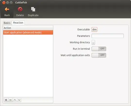

Next you need to set up the reaction.Go to Reaction>Applications>Start Application(Advanced Mode)
Set Application
Now choose the executable as dim(file that we created earlier)
Set Application
