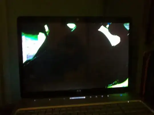

I have a HP dv7 1020us with a Nvidia GeForce 9600M GT. My internal monitor is broken, so essentially I cant' use it, as I can hardly see anything through it.
Laptop screen

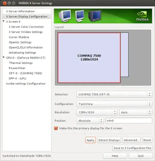

Unfortunately, it seems that something, whether xrandr, or the nvidia driver, is reading my external monitor incorrectly. Nvidia settings is not allowing me to clone the screen as it did before (I have it set to clone, but it acts as if I have two separate screens).

Nvidia-settings:
Nvidia settings

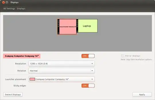

My Monitor:
My monitor is a Compaq 7500 CRT monitor. Google searching says that the max res is indeed 1280x1024, but I have used it at 1440x900 for over a year now - so yes, it can achieve the laptop's resolution. I think the problem is that it is being reported as the wrong kind of monitor:
Display Settings
This is incorrect, as it is a 17" monitor, and it supports way more resolution options that it's displaying.
