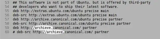

Evey time I try to install skype it says :
Reading package lists ... ready
Building dependency tree
Reading state information ... ready
The package skype-bin: i386 is not installed, so not removed
0 upgraded, 0 newly installed, 0 to remove and 1 not upgraded.
E: Malformed line 60 in source list / etc / apt / sources.list (distribution analysis)
E: The list of sources could not be read
Erikson
  • 121
You have spelling mistakes in lines 59 & 60, you should just remove the lines completely.
/etc/sources.list spelling errors
Then, Ctrl+Alt+T and sudo apt-get update
