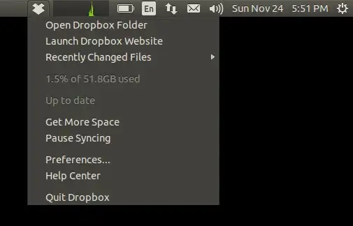

The end result should be something like:
Tested on 12.04, 12.10, 13.04 and 13.10.
